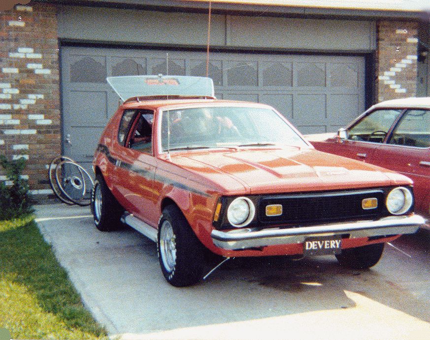

Finally got my airplane sold. A good part of the 1990's was spent learning to fly then getting my own airplane to reduce the costs. I love to fly, but it's too expensive for me, so that is when I decided to get my project truck and learn all about vehicle restoration. It was a great choice! I have met a lot of great people doing this. What's with the Gremlin?

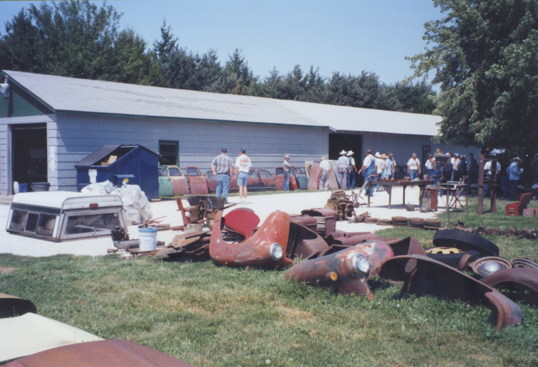

These are some shots of John Erb's retirement auction. I met a fellow oletrucker there (Brian Stephens) and it was a pretty good day. I had spent the three weeks prior helping John get ready for the big day. Wouldn't you know he would pick 100 degree days to do all the work! John was a great guy and I miss him.
John wasn't only an AD expert, he was also an Antique Tractor buff as well. He really knew his tractors and as a result did pretty good at the auction. They really stole the show!

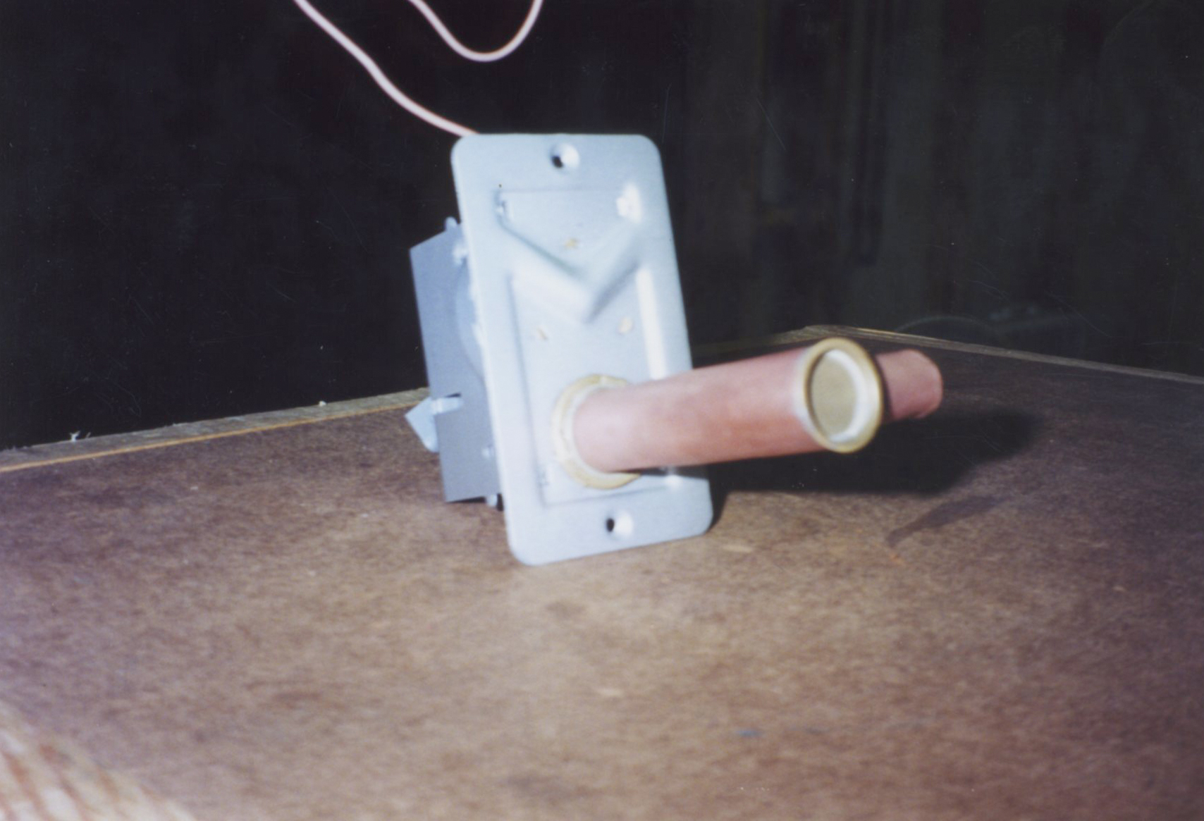

The 49 3/4 ton's cooling system died (completely) and needed an overhaul. I had to replace the radiator, water pump and hoses. I took the time to refurbish the heater control valve. This is something that is almost guaranteed to leak if you don't replace the seal. These pics were going to be a step-by-step on how to do it, but the film didn't turn out on all the important pictures. Suffice it to say that I did it and can help you if you need it too!
This is the done heater control valve. Not impressive unless you see all the pics I had to throw away that were the in-between shots. Oh well! Meanwhile, I added a goose-neck on to my little trailer to accommodate the higher hitch on my 49 3/4. What is unique about this trailer is it uses a 1947 3100 front end as its axle. Even the rims sport the proper baby moons. Plans are to sandblast, repaint and add side rails to give it more depth. I have the side rail pockets already but haven't taken the time to weld them on.

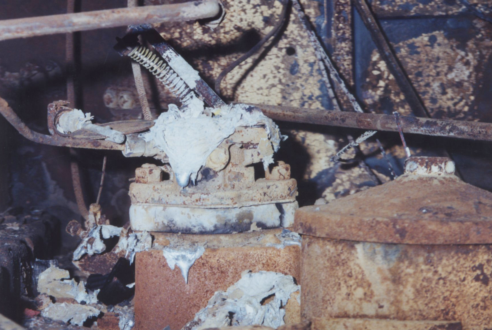

Here I am at the auction beside my new acquisition. I was so surprised when I turned out to be the only bidder! I got this 1948 1-1/2 Ton (4400) for $50.00! I wanted it for the 1959 235 engine, but after looking it over, its very complete and I feel a good candidate for a complete restoration. As if I need something more to do! Meanwhile, We had a terrible fire at one of the storage buildings around Hesston. It was devastating for many people who lost some very valuable cars and trucks. I was given this 1954 3100 for the price of hauling it away.
As you can see it isn't pretty. Fire does awful things to a truck. Warp-age is the worst. Just getting it on and off this trailer was a task I would rather forget!
The carb just melted all over the manifold and the interior was a mess. Is this one heck of a deal or what?

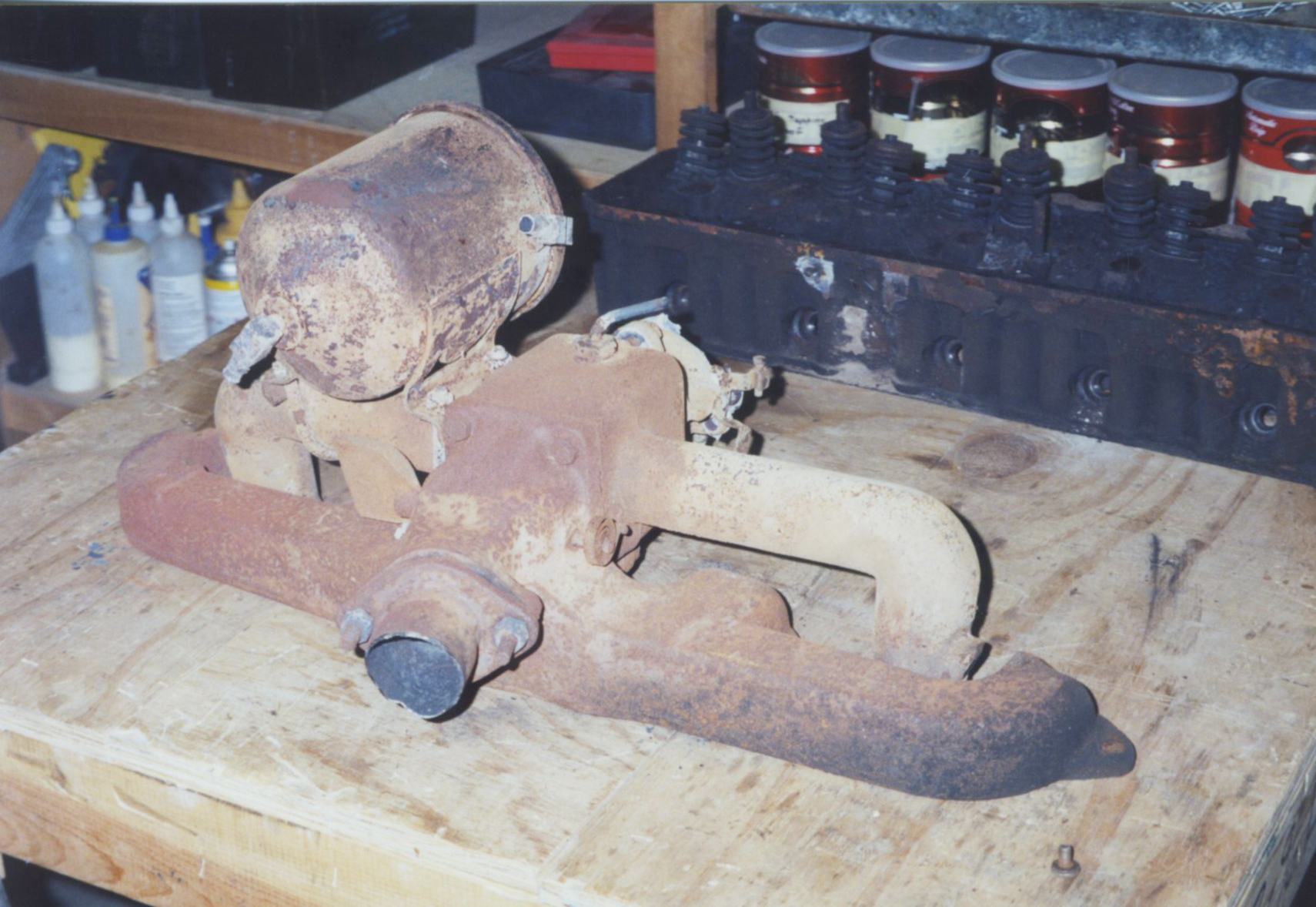

These are shots of the 235 engine. The pistons were stuck solid to the piston rods. Took a lot of work to free them up.
The head was a mess and turned out to be cracked. The manifolds were in good condition and I cleaned and repainted them. Looks like new!

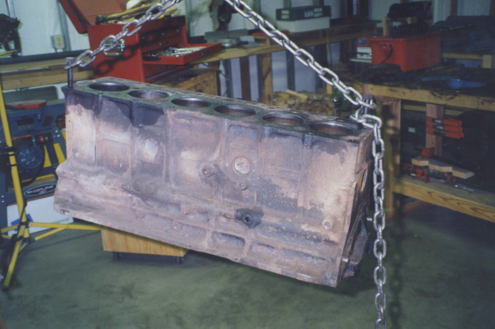

I took the engine outside and sandblasted it. Inside and out, the block looks like new. The lifters were also almost impossible to remove, but after stripping it completely down and sandblasting, I took it to the engine shop for inspection. It passed so I am now working on rebuilding it. I will sell it to someone who needs a great engine. Lofty goals! For someone with almost no experience with this stuff, let's see what happens!

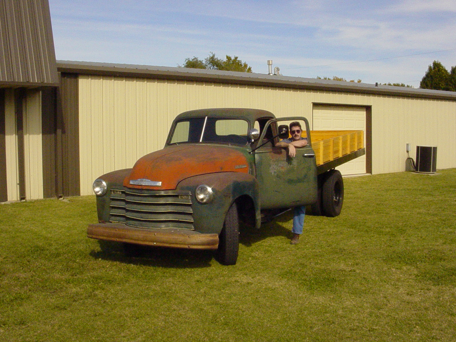

As I said before, I purchased a 1948 4400 Ton and a Half at John's auction. It was in very bad shape. Tires toast, windows all broken out, engine no idea, no bed but had the dump mechanism. Here is my friends Jerry Mast, John Erb, and Bud Bachman all looking over the truck.
As I said before, I purchased a 1948 4400 Ton and a Half at John's auction. It was in very bad shape. Tires toast, windows all broken out, engine no idea, no bed but had the dump mechanism. Here is my friends Jerry Mast, John Erb, and Bud Bachman all looking over the truck. With their help, we got it running. Low compression, but drivable!
Changing out the window glass and rubber was pretty straightforward. Since the brakes were shot, I put it up on jack-stands and proceeded to completely go through the entire brake system. New everything. Hard to find some of those parts for the larger trucks, but I managed. It stops about how they all do, okay for their time, but probably not okay for todays driving.

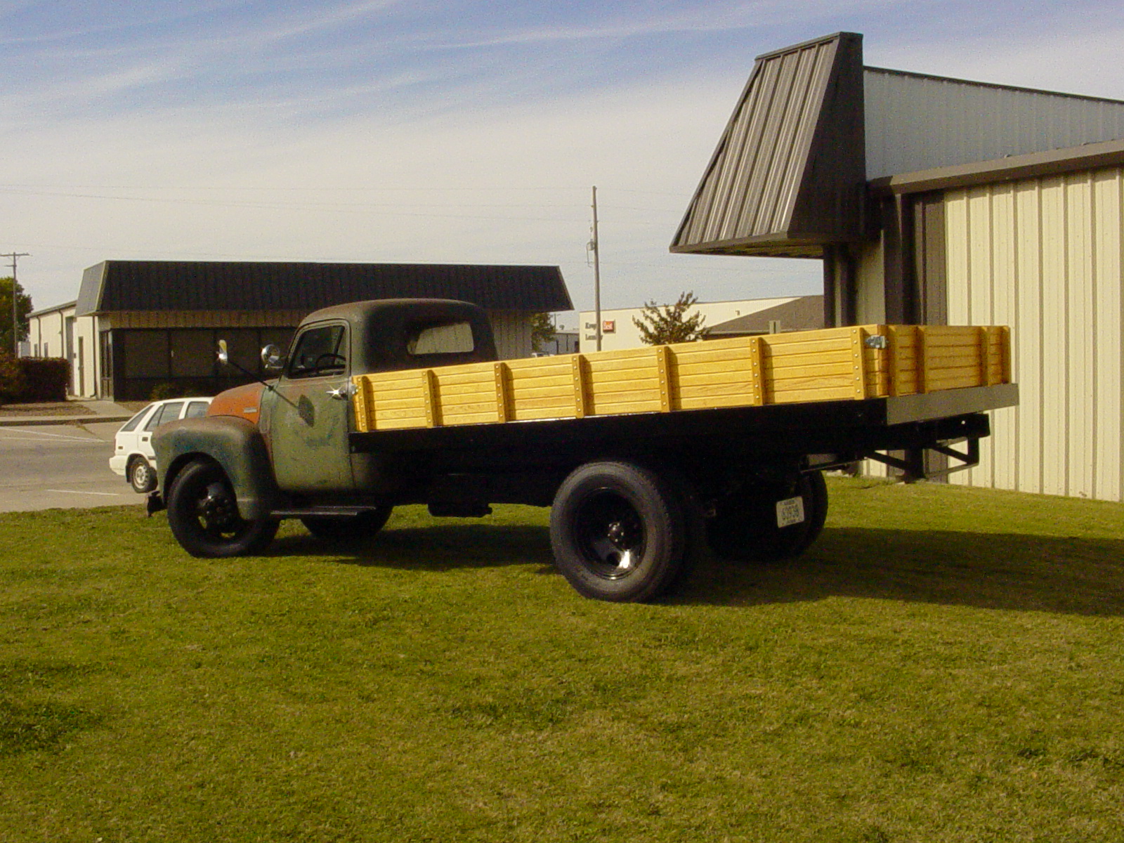

I really wish I would have taken more pictures of the process, but as a amateur woodworker, I decided it was time to do something about the bed situation. I used long planks of Tongue in Groove 2 by 8 Doug Fir, and then dressed out the sides with some nice tongue in groove 1 by 4. I found some nice hardware to connect it all together. Now it's actually useful!

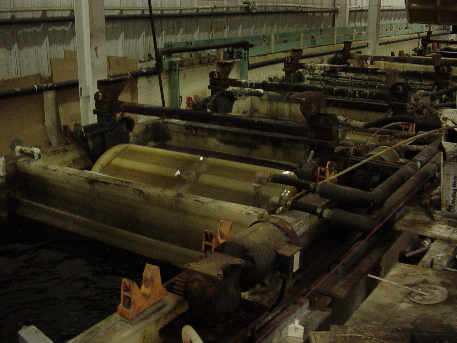

These were taken on our field trip. We went to the electro-plater in Minneapolis, KS. I wanted them to see how Zinc Plating was achieved. They were amazed at the different plating processes available and how they were accomplished.
They pretty much decided on not pursuing a career as an electro-plater! Smelly, nasty work, but a true education on how this is done. I was very appreciative that the owner took his time to show us the process.

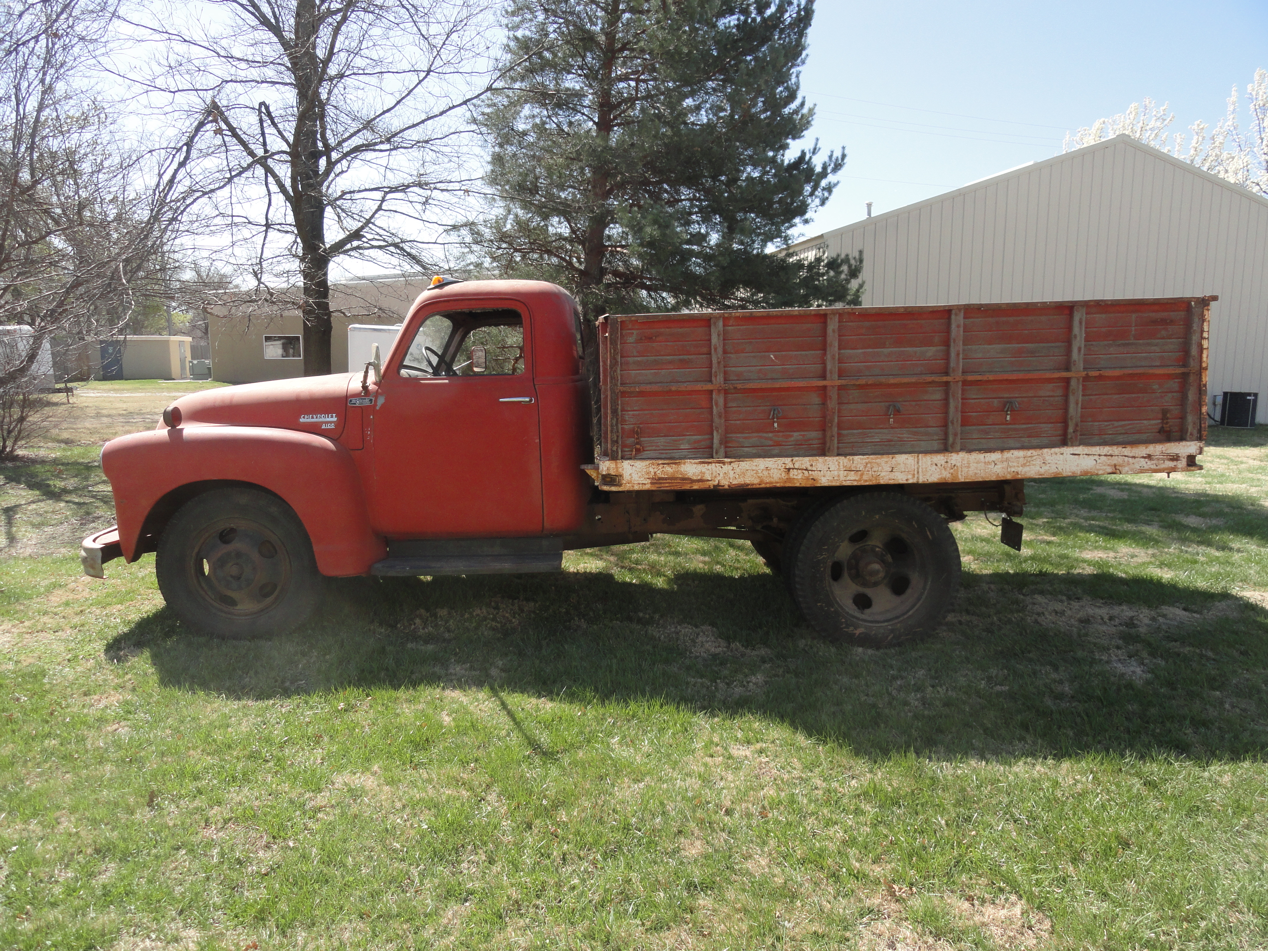

I got this truck from my Uncle Art who drove it right over after getting it from a farm auction. It has been sitting in a maintenance shed all its life and the metal is in great condition (considering 66 years). This truck is unique in that it's a 4100 Short Bed Grain Hauler which is not seen much in Kansas because everyone opts for the larger capacity long wheel base. This short wheelbase fit in a standard sized garage despite the very wide bed. The PTO Driven Dump Bed is pretty cool too! More pictures below.
